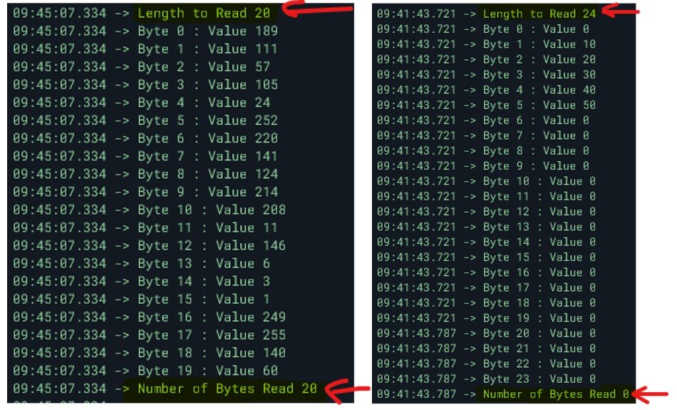

hi,
I'm working on I2c with I2C master with TTGO ESP32, I found that transaction read is working well with length (LengthToRead)<=20 if more than 20 not working.
I2C read.jpg (142.09 KiB) Viewed 8741 times
I2CRead.fcfx
(20.38 KiB) Downloaded 780 times
Thx for your prompt reply

I put to 20 before to send you to make a test and forget to replace by 24 but even if you increase it to 24 the result will be NG.

Yes, I've just checked the generated code and you are correct.
The I2C Master component is limiting the buffer size to 20 bytes, as passed to the I2C CAL component, and the CAL C then inhibits the transfer of 24 bytes into a 20 byte buffer.
