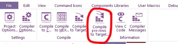

Would it be a option to have a function in FC that uploads the last generated files without compiling again?
Would look like this:

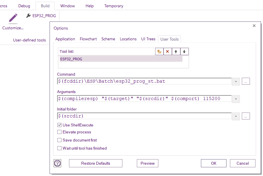

You could use the "User-defined tools" facility of Flowcode v10 (in the Build menu) to create your own button to do this. I have done this for my projects.
By clicking the "Customise" button and then selecting the "User Tools" tab in the Options screen, I created a button called "ESP32_PROG" with the following settings:
Command:
   $(fcddir)\ESP\Batch\esp32_prog_st.bat
Arguments:
    $(compileresp) "$(target)" "$(srcdir)" $(comport) 115200
Initial Folder:
    $(srcdir)
The "Use ShellExecute" needs to be ticked. Here's that screen, showing the button on the toolbar under "Build":
esp32_prog command.png (42.32 KiB) Viewed 3985 times

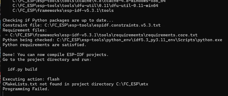

I think there's still something wrong with the path. C:\FC_ESP\mtx exists but is empty.
But in C:\FC_ESP\mtxesp32_s3_sdkconfig there is a file CMakeLists.txt
