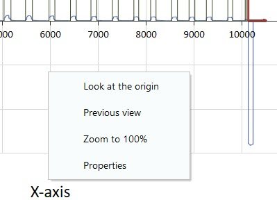

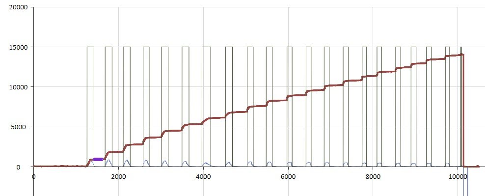

However, you can view the data while the simulation is running (and after simulation has stopped) by right-clicking and selecting "Show stored data". This will then allow you to view, modify, export the data as a CSV and import data from a CSV. In fact, this can be done with any of the 2d Chart components
That's great.
This is so good that it must also work in the finished App!!
i mean in the deploit(exported) App.
I have seen this also works with the chart. Can you also add an export all 8 series , or mark which series will be exported.

stefan.erni wrote: ↑
Wed Feb 23, 2022 8:29 am
Sometimes I have very big charts
Yes - this will work with deployed App Developer apps as well. But only one series can be exported at a time.

Hi Steve
If it's working with deployed App Developer apps, how to do it there?
With the mouse-button I have just a zoom possibilities.
Re: App Developper: How to use DataSheet
Posted: Wed Feb 23, 2022 12:40 pm
by Steve-Matrix
Hi Stefan. You are correct - it is not available in a deployed App. I will look into this and investigate.
