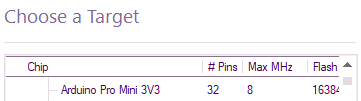

hello.
There is also an 8MHz version to choose from:
Mini 8MHz.png (4.39 KiB) Viewed 4294 times
What is the value of the crystal?
