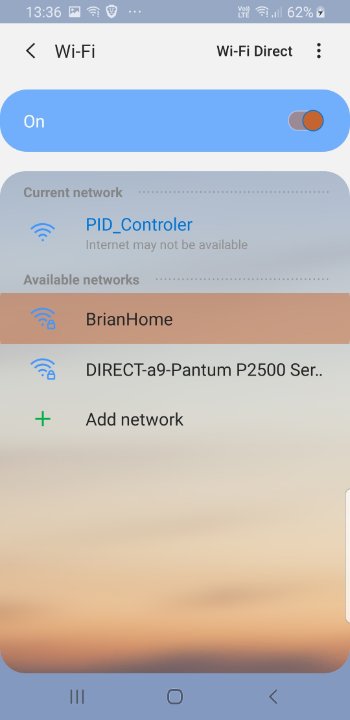

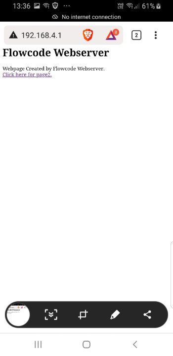

I exported your macro "Initialise_WIFI" then imported it into my program I also added a circular buffer and web server and copied your setting but I cant seem to be able to get this to work I can connect to the network but there is no fields to fill in so I'm not sure what I'm doing wrong? It seems to be pointing to a different web page.

I found the issue I never filled in the HTML Code it all seems to be working
