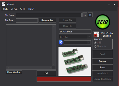

I have a ECIO40.
When I plug it in to my PC It shows:
mLoader with ECIO40 connected.png (67.67 KiB) Viewed 7795 times

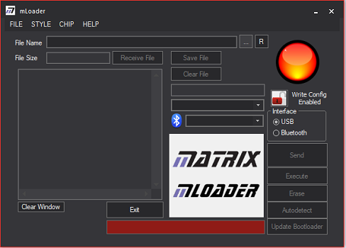

With ECIO40 unplugged I get:
mLoader with ECIO40 unplugged.png (56.13 KiB) Viewed 7795 times
I know you have the ECIO28, but they should act the same, except mine shows 18F4455 and yours will show a different target device.
