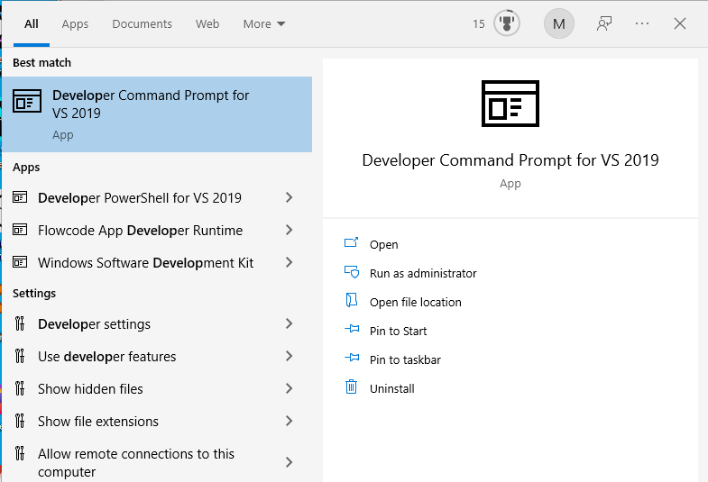

Can you check that Visual Studio Developer Tools is correctly installed?
To do that select the Start menu and type develop
If it's installed you should see:
Developer Tools.png (44.4 KiB) Viewed 6824 times
That is on my Win10 PC.
I have just checked on my windows 11 PC and I also get the Developer command prompt for VS 2019 appear on it as well.
Open the Developer Command Prompt for VS 2019 and you should see:
Developer Com Prom.png (10.27 KiB) Viewed 6824 times
Is that what you see?
If not, then you have an issue with VS BuildTools 2019

the problem was that i was downloading and installing visual studio community not build tools
thanks
