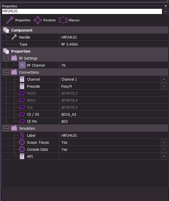

How to use the nRF24L01 module in Flowcode V9? Unfortunately it doesn't work for me.

Posted: Fri Oct 14, 2022 10:09 am
by BenR
Does it help if you lower the SPI clock frequency by increasing the Prescale property. 16MHz / 4 could be too fast if there are wires or lengthy traces going to the modules.
I think I still have some of the modules here so let us know if you're still having problems and I'll see if I can get them working for you.

How to set the CS/SS pins?

I read this in the code compiler: (Arduino Nano 328)
"Important user information. Please read." - OK
"Hardware SPI may cause a lockup in your program if Hardware SS Pin is left as an input!"; - what is the solution?
"Suggest using the SS pin as the CS pin to ensure no lockup." - how to set this up?
"Refer to the device datasheet for the SPI hardware SS pin.";
Re: Flowcode example Arduino and NRF24L01
Posted: Sun Oct 16, 2022 12:29 pm
by mnfisher
You need to either use pin 10 as CS (chip select) or set it as an output.
Easiest is to use B2 as CS in the nrf code but you can output something to it instead of required.
