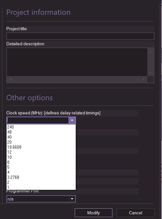

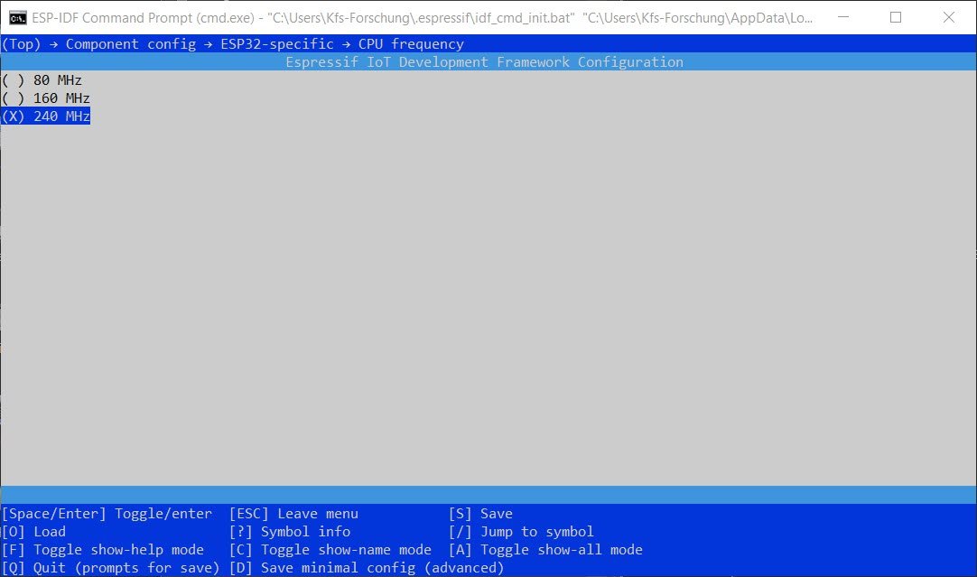

For the ESP32 it's in the config file but Flowcode has no option for 80MHz.
Info about it:

It's a combo box, you can type in your own speed

Hi Leigh
Thanks a lot for the info.
I had to enter 80 few times and then it worked.
