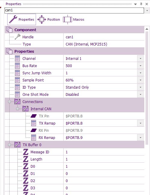

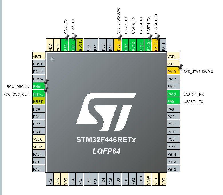

it seems to me that on the internal CAN component on the STM32F446RET6 chip CAN1_RX and CAN1_TX have been replaced according to the STM32CubeMX
in flowcode is
PB8 should be CAN1_Rx
PB9 should be CAN1_Tx
Since Flowcode does not give an option in the drop menu to change, is there is another option to swap RX and TX pins

Many thanks for letting us know, hopefully that is now sorted for you via the Help -> Library Updates.

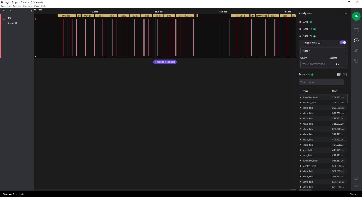

Thanks a lot for the quick response and corrections now CHAN tx works perfectly :D :D ,
but I can't get anything on RX.
NI-CAN (as a sender) sends a message properly, if I put pin B8 as input I detect the signal, but Can1::CheckRx(0) is always 0.
logic2 log.jpg (67 KiB) Viewed 5383 times
Looking at Cubemx there is a possibility to enable CAN1 Rx0 and RX 1 interrupt but this possibility does not exist in Flowcode (maybe is interrupt enabled automatically after initialization CAN component I don't know :) )
Should there be an interrupt for internal CAN communication similar to Uart or not?
