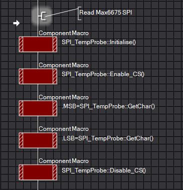

Is the below code what you mean as I have tried it and does not work
SPI Max6675.PNG (26.61 KiB) Viewed 7157 times
Re: XPT2041 & SPI Conflict
Posted: Mon Jun 13, 2022 8:09 am
by jollybv
Hi guys
I had a good weekend of programming my project is finished the only issue is the clashing with the XPT2046 touch sensor and the SPI bus (max6675) please is there any help on how i can resolve this. The XPT2046 touch sensor is working like a dream but the MAX6675 only reads once

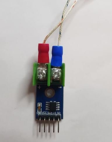

Thanks that worked I put a 250ms delay after I read the max6675 and before i do the calculations. It is now reading just it is reading 41 degrees and should be 21 so its 20 degrees out. I can subtract 80 from RawData and correct it but 20 degrees is a bit excessive

Hmm your code to do the temperature bit shifting looks ok to me but that error seems very large.
Are you using a type -K thermocouple?
How are you connecting from the IC to the thermoucouple? it is making a good connection and is there other bi-metal action going on that could be effecting your readings? I think we use good quality screw terminals here to join to the thermocouple wire and that works fairly well.

I'm using a Max6675 breakout board a K probe and the connections seems good to me. I have 2 of these boards and they both doing the same.
