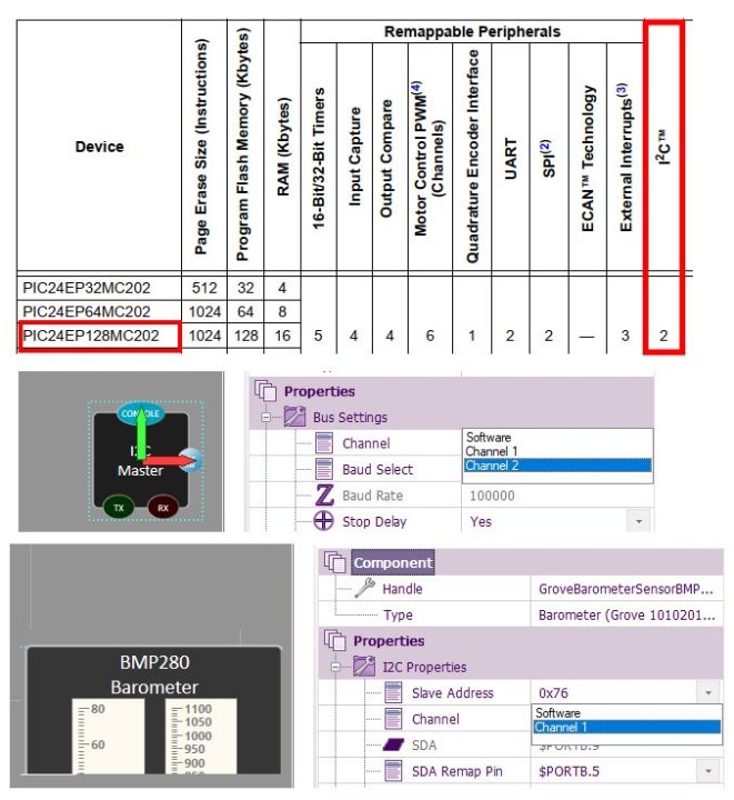

Using PIC24EP128MC202. Placing I2C component shows 2 channels for I2C. Component "GroveBarometer BMP280" shows only channel1?
I need the second channel while channel1 is occupied. Is this a bug?

Re: BMP280 pressure sensor
Posted: Mon Jun 20, 2022 11:44 am
by BenR
Hello Jorg,
Many thanks for letting us know.
I beleive I've now solved the problem for you and the latest component should now be available via the library updates.

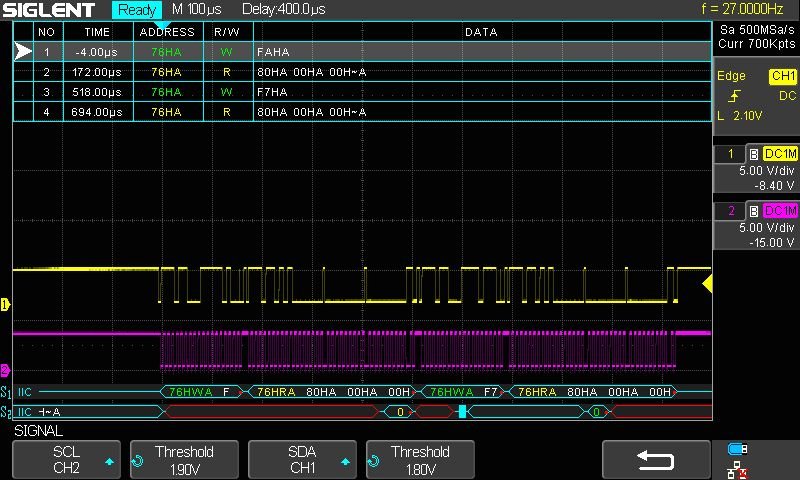

Thanks for quick answere. I uses software I2C for starting my first going with the sensor. Temperature and pressure I got back the value "0" ?
Reading altitude got`s a value about 12000 ? On the picture you can see the oscilloscoped screenshot of reading the temperature. Address is correct and the modul works correct in I2C. Why is the value "0" ?
Jorg
Posted: Wed Jun 22, 2022 10:32 am
by BenR
Hi Jorg,
Looking at the code the return 0x800000 means the data is not ready.
Maybe try calling the Forced_Read function before you call the ReadXxx macro and hopefully that will help.

Posted: Wed Jun 22, 2022 5:14 pm
by Jorg_Guldner
Hello!
I tried your hint, but it is not working. By all the trials after more than a minute the software was reading the values, suddenly a value of 2212 is displayed. This could be 22,12 degrees. But I couldn`t reproduced this situation through starting the controller again..
Then I replace the sensor component with a I2C-component. First I write "the force-read" and then the read out of the temperature. No success! The result is the same --> 80h 00h 00h. After disabling the "force-read", the software reads out 5 differants temperature values (msb --> 252,128,112,110,109) and repeat them ever (not the right values for temperature). This modul seems to be very tricky. Between all I2C-actions I placed differant delays in differant times, although no success. A 2s delay let the I2C break down.
Have you any more idea?
Jorg
