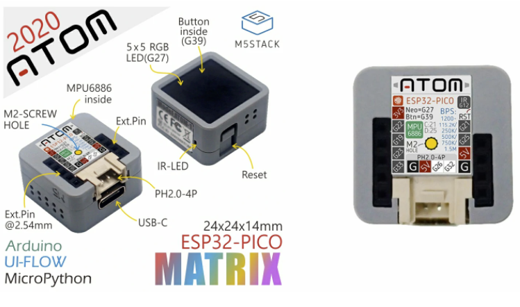

There is a another small cheap ESP32 module for less than 10 euros. It can be easily programmed with FC9.
I put an external led on pin G33 and it's flashing nice. But if I init the LEDWS2811 its not compiling anymore.
Also some another components make problems on another ESP32 Modul.
Is this just on my computer?
Some info about the modul:
https://www.digikey.bg/product-detail/e ... D/12088569

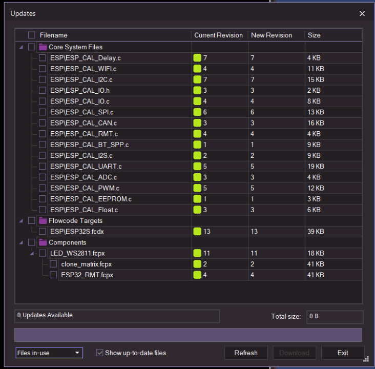

Re: ESP32 problem with components
Posted: Tue Aug 31, 2021 10:45 am
by BenR
Hi Stefan,
Have you done a full database update it looks like maybe the rmt component is maybe not fully up to date.
I'll do some tests here and double check everything is OK at this end.

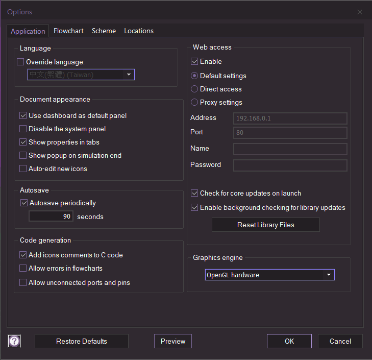

Posted: Tue Aug 31, 2021 11:24 am
by stefan.erni
If you mean the component library, yes I prefer always to do all the updates from the complet library.
Or do I have to reset the component library?
