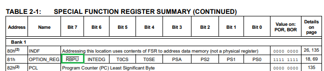

If the bit name has a bar above it like this:
The you must precede the bit name with a lower case n.
So to enable weak pull-ups on PIC16F1825 for example, you can use
cr_bit(OPTION_REG,nWPUEN);
or
OPTION_REGbits.nWPUEN = 1;

This had stumped me some time: how to name a bit called (overbar)WPPU in the data sheet.
Of course: OPTION_REGbits.nWPPU = 1 !
Thanks (again) Martin.

If you ever need to know the specifics for a PIC device then the easiest way is to look at the .h file in the compiler pic/include/ directory.
For example for the 16F877A I looked at the pic16F877a.h file.
Then search the file for the register your interested in, here is the section for the OPTION_REG register.
