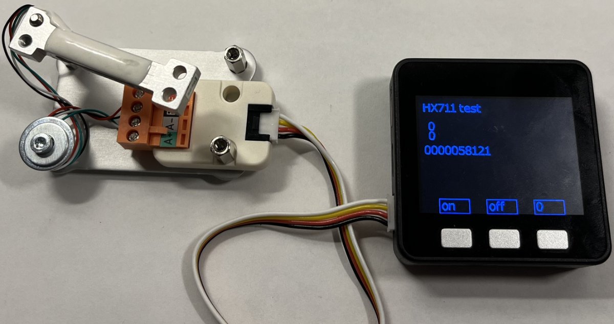

I am trying to build a pressure sensor for 50Kg.
For this I test first with a 500G sensor because it is much easier to load 500G than 50Kg.
I'm testing different HX711 boards. Everything works fine.

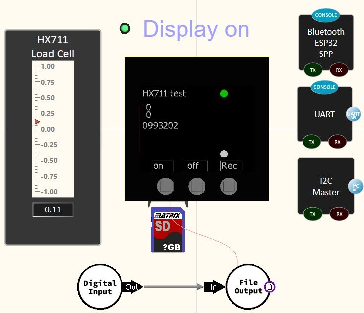

But with the DSP Output CSV there are small problems with the clear data. I can save the data to an existing dsp.csv ffile but I cannot delete and rewrite an existing file. (clear data)
It would also be easier if the file name could be selected with a command.
Demo_ESP32_post_hx711_sd.fcfx
(66.64 KiB) Downloaded 500 times

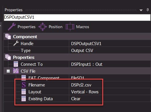

But one more question. These propertis are no longer usable, no influence?
Re: DSP Output CSV1 clear data
Posted: Wed Sep 28, 2022 4:12 pm
by BenR
Hi Stefan,
Thanks I'll investigate for you and see what I find. Could be the ESP is going at a rate of knots and something is too fast or needs a delay to relibly perform the log. Sounds like directly after creating the file the log doesn't work. The clear operation basically deletes the file and then recreates each time you open the file. The OpenFile macro has a new return value so you could look at this to report the state of the operation. You could also try opening the file in clear mode to delete the file and then open the file again in append mode and hopefully it will then accept the data you put into it.
The two properties you highlighted (Filename and Existing Data) are the defaults, so prior to calling OpenFile in your program then these are the values that will be used and OpenFile will be called for you behind the scenes by the component. If you do call OpenFile then that will then override the defaults. Layout is always being used though we might want to try and make this a variable feature too.

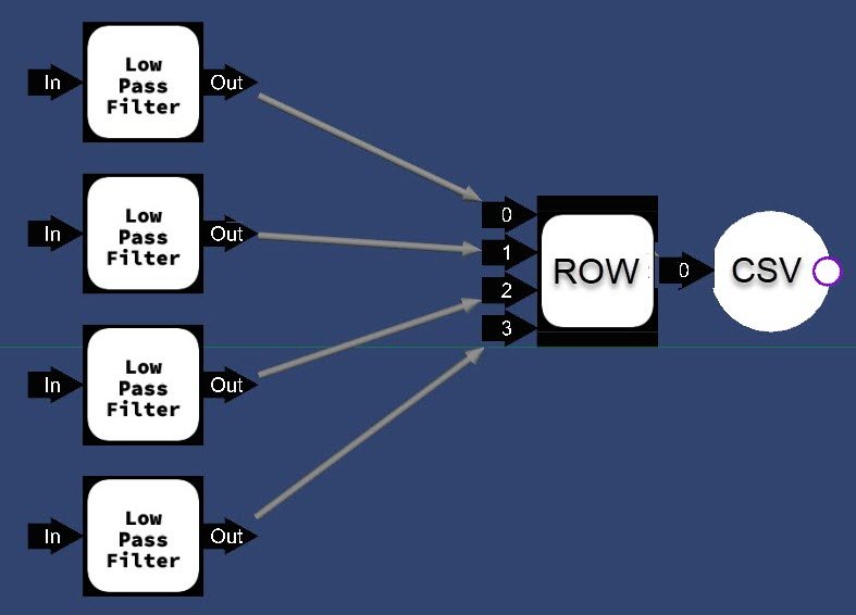

But unfortunately later I have two HX711.
Is there a possibility for two or more rows with the DSPcsv in the future?

Yes that certainly would be nice, I have an idea on how to do it so I'll see what I can do.

Something like that maybe...

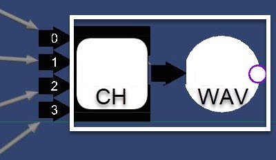

and later also a WAV file with a choice of channels

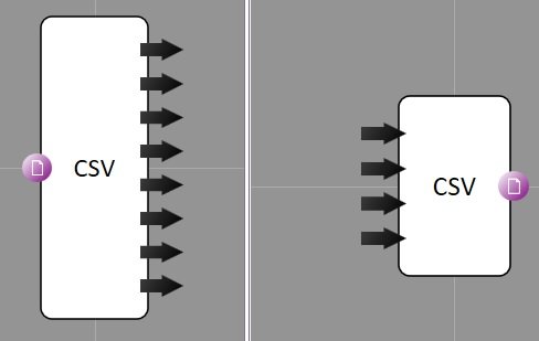

Do you have access to the v10 beta, I might make the changes there as I'm doing some DSP work for v10 anyway.
This is what I have so far but it's not quite ready yet.
The input would read a row from the CSV and put the first column into the top buffer, the second into the second etc. On the next pass we would skip through the file until we get to the start of the next row and then start again.
The output would do a similar job, each write would write a row into the CSV by taking a value from each buffer in turn to write each column entry.
