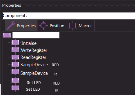

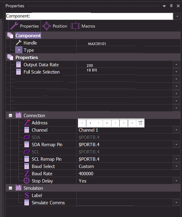

Would it be possible to create a component MAX30101 in advance with just a few commands and propertis?
So we could try to analyze HR and SPO with the DSP components.
Commands:
Init,
write register,
read register
sample RED (read long)
sample IR (read long)
SetLed RED (mA)
SetLed IR (mA)
Propertis:
Datarate 200Hz
18bit (read long)
data / clock pin
the adress
Baudrate

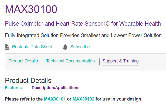

Commands:
propertis:
Info about the MAX Numbers.
I suspect all 3 types are software compatible:
