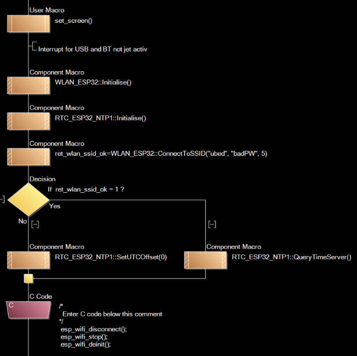

We can certainly look at adding a disconnect macro. Does the following C code do what you need?
 esp_wifi_disconnect();
 esp_wifi_stop();
 esp_wifi_deinit();
Re: ESP32 Real Time Clock faild
Posted: Wed Oct 12, 2022 2:46 pm
by stefan.erni
Yes it's working fine.
If the password is correct it's set the time (with 2hours offset)
If the password is bad it's set the time to 00:00:00 ( 2hours offset is set to 0)
Always the HX711 is working nice.
These 3 commands could also be useful for other applications, if it is not too complicated I would add them to the component.
But for me it's already perfect.
