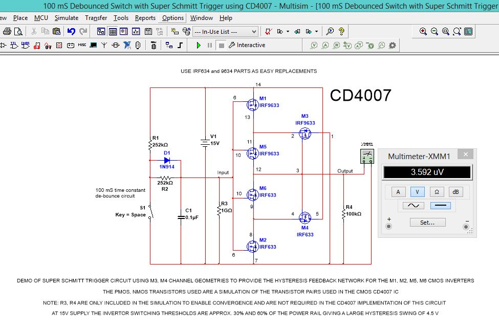

The best way I have ever seen to combat contact bounce on any switch is to use a combination of a short delay and a super schmitt trigger circuit. It's like using a sledge hammer to crack a walnut but it works every time when simpler circuits fail. It adds an extra component to the input of a uC but one of the best super schmitt triggers can be made using a CD4007 CMOS logic chip. Do a Google search on using CD4007 and schmitt trigger.
FYI a super schmitt trigger is like a normal trigger except the hysteresis low high thresholds are much wider than can be obtained with a standard trigger. When you add this on to a standard short timed delay logic circuit you get zero contact bounce on any switch.
The attached file shows a simulation of this technique that I built in Multisim using ordinary MOSFETS to replace the CD4007 because the available CD4007 sim models are useless.
100 mS Debounced Switch with Super Schmitt Trigger using CD4007.jpg (100 KiB) Viewed 3830 times
