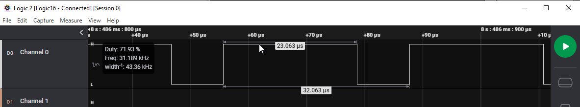

I have tested your project on a 16F1825 and the PWM frequency is correct.
PWM Frequency.png (34.41 KiB) Viewed 7335 times
I have not got a DAC to test.
If the DAC is the issue, then maybe the timer4 interrupt is causing an issue as it is set to 31KHz, the same frequency as the PWM.
