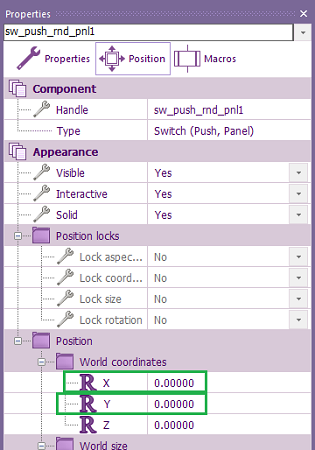

The only issue I can see (which should not cause the issue you are describing is the switch X & Y position values are way too high for me, so the switch is a long way from the center of your 2D panel.
To correct that, right-click on your 2D panel and select properties.
Select your switch component from the drop-down arrow at the top right of properties.
Click on the Position Icon that is just below the drop-down arrow and change World coordinates X and Y to 0:
Change switch postion on the 2d panel.png (62.51 KiB) Viewed 4726 times
