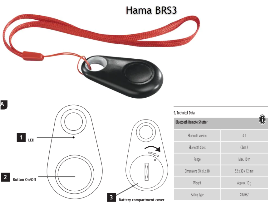

Hi to All
I am looking for commands to control an Android or Iphone with an ESP32 via Bluetooth.
There are already small cheap devices that do that.
But I would like to fire two additional flashing LEDs with the ESP32. These LEDs are small and very bright for a short time.
Does anyone know this Bluetooth command code?
Sample small device.
BT Command_2022-10-21_17-16-11.png (271.47 KiB) Viewed 11933 times

Hi Stefan,
I guess you would need a small app running on the phone - I've thought about this for photography and have seen the remote shutter switches. I'm also trying to think of a way to interface a bike radar to an esp32 - rather than having my phone strapped to the handlebars.
It might be possible to look at the Bluetooth traffic and see what data is being transferred. It would be fairly easy if can connect to a PC not so easy if it's BT LE?

Hi Martin
It's not using an app. Just connect to the Iphone or android phone. You have to open the camera and thats all.
If you press the button it's focus and take the picture. If you press the button long it's take a video.
I don't know if it's a remote profile or SPP, but not BLE
I'll keep looking and keep you informed.

Looks like the Bluetooth 'clickers' act a small BT keyboard - with 'Enter' as the (only) key to take a photo.
See https://stackoverflow.com/questions/267 ... 20Marc%20B

So - using the techniques I mentioned in the esp32 Bluetooth Mesh topic - I added a simple BT keyboard to esp32.
This connects to a PC (you need to pair it) and here has a very (very) simple keycode generator - it takes a string (only handles capital letters and space) - and outputs it as lowercase letters (need to add a 'shift') and (relevant to this topic) a return character (which should (!) fire the shutter) Way back I did a more detailed version for Arduino HID and I'll look this up rather than recreate it.
It required a little extra tweaking compared to the Bluetooth mesh example - so rather than try and post all my steps again (needed a little more modification of the demo file) I've posted my entire directory as a zip. Note that as mentioned before - you'll need to compile and upload outside FC (using 'idf.py build' and 'idf.py -p COMn flash') - you'll need to compile the fcfx file to create the directories (in FC) then paste in the contents of the zip file then use idf.py commands.
The (simple) demo file - outputs Hello World(return) once - it needs a trigger (button / timer whatever) - simply outputting multiple strings makes thinks difficult on the PC.
There is no delay after the chars - depending on your PC it might need say 10ms??

Just tested with a phone - sending a RETURN (keycode 40) - every 10s does indeed take a picture :)
