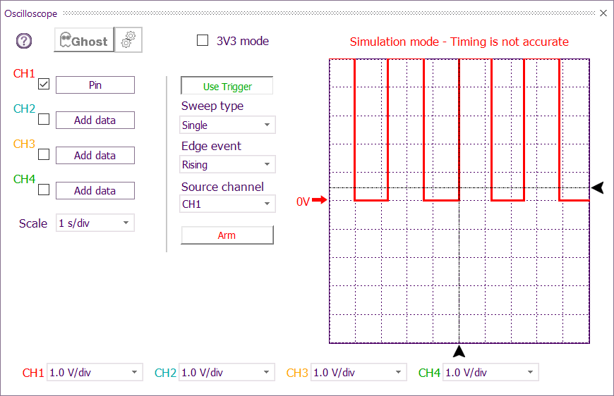

I've tried following your instructions and I'm not seeing the problems that you are, but I am keen to get to the bottom of this and understand why we are experiencing different things. I am using the latest build (v9.3.1.36 dated 1st Nov 22). Here's what I am doing:
  1. Open your file in Flowcode
  2. Start the simulation - the oscilloscope shows a repeating trace
  3. Click "use trigger" and the oscilloscope clears
  4. Click "arm" and the oscilloscope remains clear
  5. Stop the simulation and edit the delay icon (to 200ms) and restart - the oscilloscope does not close, and remains clear (it is waiting to detect a transition)
  6. Drag the black arrow up so the trigger point is within the range of the trace and the trace is shown. It is in "single sweep" mode so the trace remains and you would need to press "arm" again to reactivate the trigger.
    osc triggered.png (42.11 KiB) Viewed 7063 times
I don't know why your oscilloscope is disappearing - that is odd.

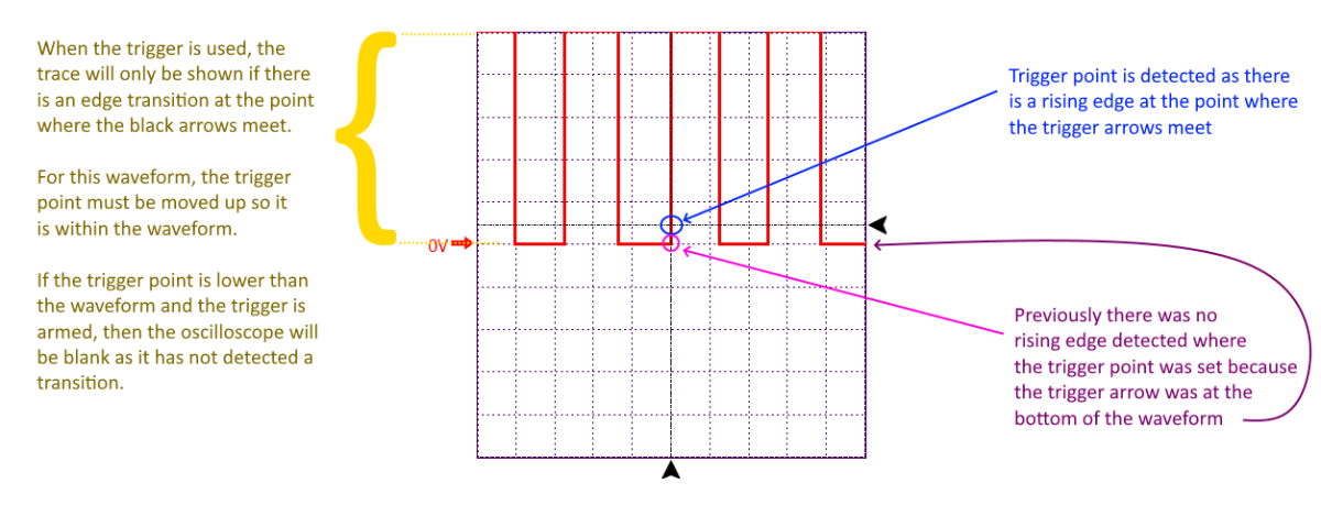

Regarding the trigger point position, I've tried to explain things a bit clearer in the following diagram for the benefit of anyone else having issues with the triggering on the oscilloscope.
osc trigger explanation.png (199.49 KiB) Viewed 7063 times
I think some of the initial confusion could be because when the project is first loaded, the trigger point is at the same position as the low point of the waveform and at this point the rising edge is not seen (it is only seen when the trigger point is above the low point, and not equal to it). I have experimented with this and changed it so that in v10 the edge transitions will also be detected at the high and low points of the trace.
