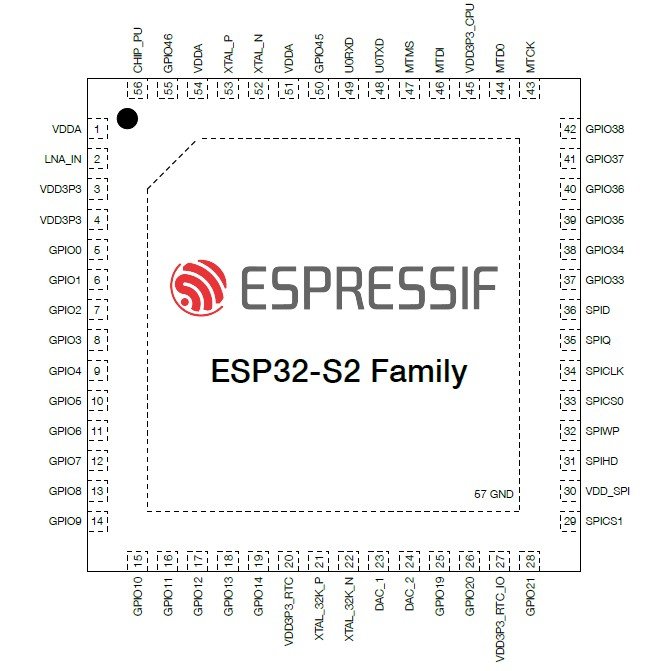

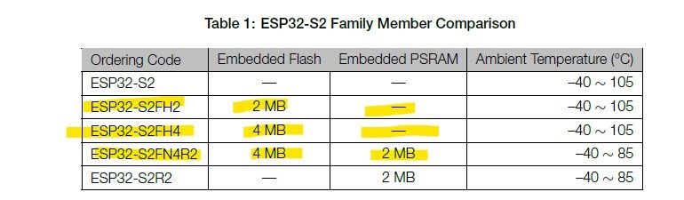

Dear Flowcode team,
We have a customer order and we need to use these Soc's ESP32-S2FH2, ESP32-S2FH4, ESP32-S2FN4R2, it's same family only embedded flash and PSRAM change. see below.
ESP32-S2 members.jpg (34.17 KiB) Viewed 13679 times
Could make ASAP the FCDX for ESP32-S2
ESP32-S2 family.jpg (69.69 KiB) Viewed 13679 times
esp32_s2_datasheet_en-1773066.pdf
(813.57 KiB) Downloaded 879 times
Thx for your prompt reply, it's urgent
