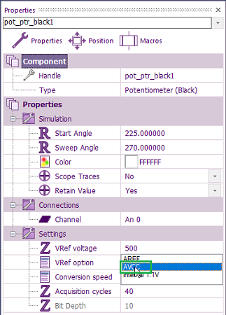

I have modified your project by changing Vref option from the default AREF to AVCC.
Changing Vref option.png (78.27 KiB) Viewed 6425 times
Additionally, I have increased the conversion speed to Fosc/128 for extra stability.
I have also added a note on wiki for each potentiometer.
