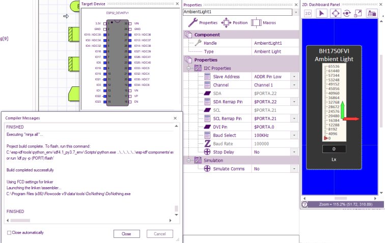

Hi Jorgen.
Happy new year to you and everyone else on the forums.
I have tried BH1750 with ESP32_DEVKITV1 target and it compiles for me with Channel1 for the sensor selected.
BH1750 ESP32_DEVKITV1.png (141.68 KiB) Viewed 3448 times
Are all your components up-to-date?
If they are not and you do a full database update, don't forget to reload your project after.
In addition to chipfryer27 post, you will need to select the pins from SDA & SCL Remap pins.
When you first add the component it should state unconnected for both SDA & SCL pins.
You just select the pin from the Remap pin below, which will be blank for an unconnected pin.

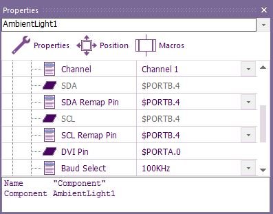

Just a quick follow up. I did use the component with an ESP and a I2C display. I only have a deleted photo so I'm guessing I was just testing code. However it did work as expected.
Incidentally, when I add the component, the SDA and SCL pins default to Port B4 including both remaps, so you will probably need to set yours to something suitable.

by jgu1
Hi Martin & Chipfreyer!
Thank´s for fast reply. Well my fault (of course) sorry :lol: Of course I know *I have to go to the rigth side of the proporties panel and scroll down and choose the alternative pin number, forgot that, notice that when I saw your att. picture.
Now no problem with compiling and it work perfect. ;)
