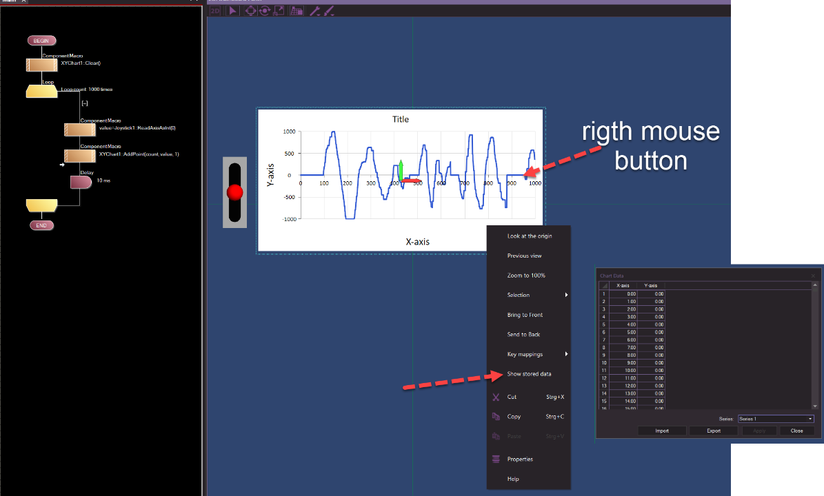

I made you a small App as a demo how easy it is to draw a chart with FC9 and save the data in excel.
Load the program and press F5.... then move the joystick at the end right click in the chart
