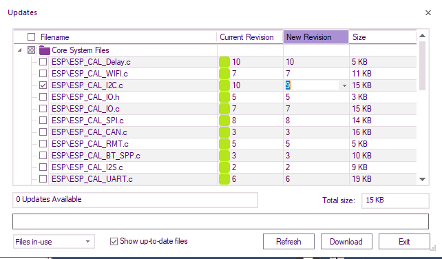

Can you please try the following as a temporary solution?
Select Help>Library Updates...
Leave the dropdown to Files in-use.
Select Show up-to-date files tick box.
Select ESP\ESP_CAL_I2C.c tick box
Change New Revision for ESP\ESP_CAL_I2C.c from 10 to 9
Changing component revision.png (30.02 KiB) Viewed 3793 times
Select Download, then reload your project and compile it again.

I try your suggest, but Iam not able to get 9 when I press the download nothing happen, the Download buttom is also "ghostet". not active.?

I have to tick on "filename" too, then I could downgrade to 9. And yes, I can Compile again, but the XPT2046 doesn´t work now, before this work I cant tell you of the BH1750 working, can´t go to next screen?
