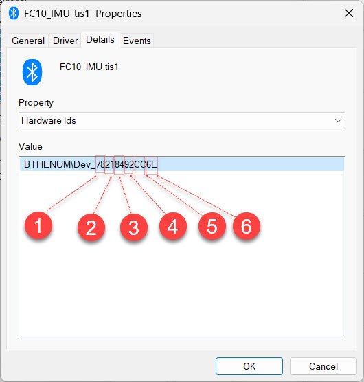

Connect an ESP32 device to App Devoper work easily and reliably.
Unfortunately, it is not yet possible to connect to a exactly specific ESP32 device with App developer.
But with add two commands this should work simply.

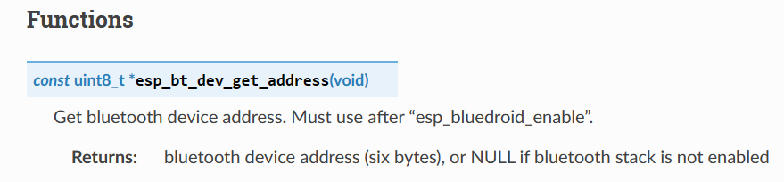

ESP32:
Would it be possible to add another command for the ESP32 Blutooth component. Reading the Bluetooh ID as described in the link. No matter as a string with or without a colon. Even just a C code would be good
https://docs.espressif.com/projects/esp ... evice.html
App Developer:
In the App there is the component comport with the command for ScanForDeviceID. This command is very helpfull if you scan for a bluetooth from ESP32 or from Microchip or for a FDTI chip.
But you can't decide between two ESP32 Bluetooth devices.
This is not practical, especially when using two ESP32 devices, one for the left, one for the right or something similar.
Or to be sure that you connect to the right module.
Actually, only the command in the App developer is necessary, but with the ESP32 BT Command you could show the ID on the display or use the BT Id to generate the BT device Name (This command already exists).
i can just add a part from the ID to the name , for example, the last four characters of the BT ID.
From the name "FC10_IMU-tis1" then becomes new "FC10_IMU-tis1-CC6E"
Would it be possible you add a scan for a specific Bluetooth ID to connect to the comport ?

With a microchip Bt Modul it's the same problem.
The following problem is probably caused by windows.
I make a bluetooth connection to my own device (programmed with flowcode) on a computer in the lab. Connecting to a comport for example comport4 works and everything works perfectly with the FC10 App.
But then my device is not in the lab for a while and the next time im starting the device,
Windows then assigns com3 or com7 to my device. Depending on whether a USB stick or something else like a card reader is (or was) plugged in. Of course then my device doesn't work anymore.
I also have an Android App for my devices. I can simply save the address of the device and the App always finds the right device.
Is there a way to do something similar with the App Developer?

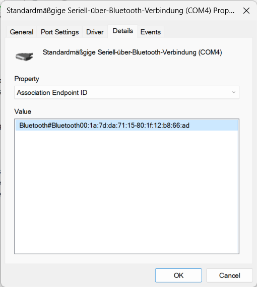

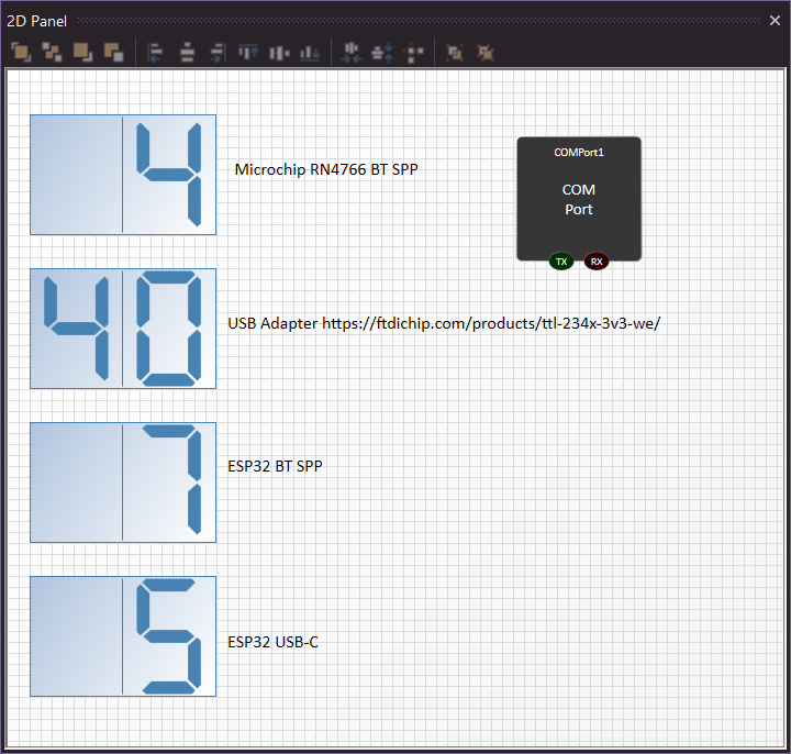

I thought you could just scan the Association endpoint ID instead of the hardware ID with a command.
but it's not as easy as I thought it would be
Yes I remember the old post...
The Comport from different USB ports or BT devices can be easily detected by FC10.
It also selects the correct com port and does not use the unusable second comport, from the SPP connection.
That is already super good.
Unfortunately, you can't search for two identical modules, it always finds only the first one, for example just from first Microchip BT Modul,
but there is no information about the second Microchip BT Modul comport number.
I have now connected the second sensor to the another device with the first sensor using a cable, so I only read the data via one BT connection.
This also works and perhaps causes fewer problems than two BT modules.

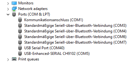

Here the list of comport:
and the correct dedection from FC10

I am going to see if the detection can search and return other instances and not just the first one. I will also try to investigate if there is any other information we can retrieve to differentiate between identical modules.

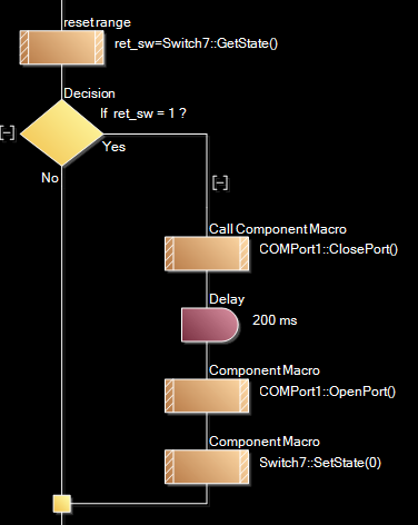

Another small experience with Bluetooth
In my program I add a switch to open the comport from a Bt modul (Microchip RN4677)
If I use ClosePort and then OpenPort I can press the switch 100times no problem.
But if remove the ClosePort and just open the port twice ( i mean open an open port) something crash very bad.
I have to remove the BT device and sometimes also restart the computer.
So before i open a port with bluetooth i always close the port first.
I suspect: Better close the port before opening it

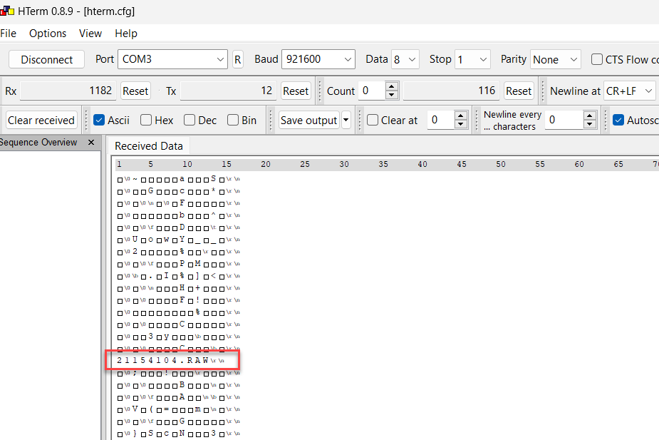

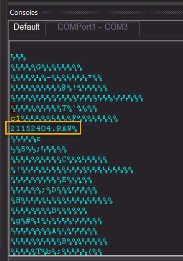

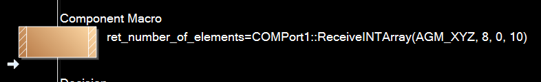

One more question.
From the bluetooth device I always get an array with 8 integer, i.e. 16byte data.
This works very well and quickly and the display in the app seems to be real time.
But once I also get the filename with 12char as a string, i.e. 12byte.
How can I separate the received data?
Can I somehow read how much data is in the buffer before I read as array or string?
Re: ESP32 to App Developer by Bluetooth with BT ID
Posted: Tue Mar 21, 2023 2:38 pm
by Steve-Matrix
I'm not sure. Ben should have a better idea on that.
