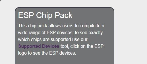

I was checking the supported devices in Chip packs but on this link there is no informations
Link to supported devices.jpg (16.2 KiB) Viewed 5914 times
https://flowcode.co.uk/embedded/index.p ... #ChipTable

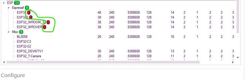

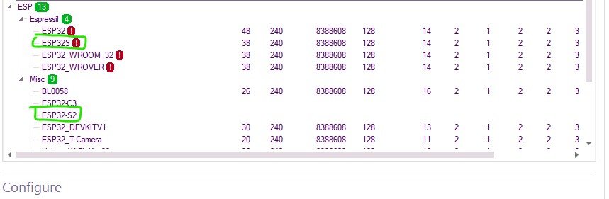

1- What is ESP32S ? and what are the difference between ESP32-S2 and ESP32S, see FC10 print screen
2- Chip with "!" mean that need to buy the pack isn't ?

1- on the first picture sent, there is one chip named "ESP32S" not "ESP32-S" but there is no "ESP32S" Espressif Chip serie !
so to which ESP Socs refer "ESP32S" ?
2- You didn't reply :
Chip with "!" (red exclamation mark) mean that need to buy the pack?
if no, what mean the red exclamation mark?

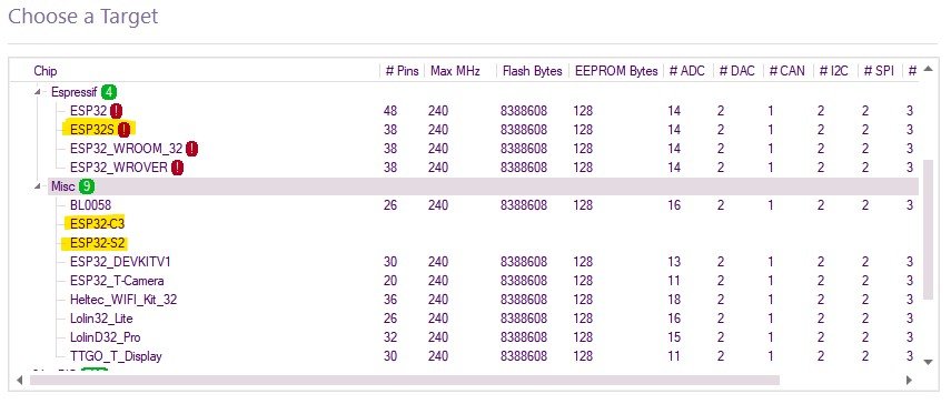

Link to supported devices.jpg (33.85 KiB) Viewed 5886 times
3- You didn't reply:
if ESP32-S2 an ESP32-C3 series are already available and free available IC , so it mean that all these ESP32-S2 series chip can be used with FC10 ?
see my post on this link.
Ben was working on it according to my request.
viewtopic.php?f=6&t=1570

Thanks, chipfryer27, for answering this initially. It really helps us staff when VCs and other users try to help as we have a large workload and can't be around 7 days a week to answer.
I've finally found some time this weekend to answer some things on the forums.
lucibel wrote:
Fri Jan 27, 2023 5:51 pm
Ben should hopefully be able to answer this one. You may need to wait until after the weekend for an answer.
The "!" means the target is unlicensed. You can still choose it, but it will not compile. But please see my post here as there is a small issue with this in the current v10 release.
3- ESP32-S2 an C3 are free available IC, so it mean that all these ESP32-S2 series chip can be used with FC10 ?
Only the targets listed in the "free" section are available without purchasing the ESP chip-pack. For ESP devices, this is ESP32 and ESP32_WROOM_32.

lucibel wrote: ↑Fri Jan 27, 2023 6:51 pm
Ok so ESP32-S2 an C3 are in ESP chip-pack.
So I'm surprised that they can be programmed with IDF4.1 like in FC9
please check your private message
thx
Re: Link to Supported device not working
Posted: Thu Feb 09, 2023 1:44 pm
by BenR
Hello Seb,
The ESP S2 and C3 are unfortunatley not yet supported, it seems the chip definitions have been put in the release for v10 but they are not yet ready or viable targets. Sorry for any confusion and I will annouce via the fourms when we have completed the work to get these in and support the newer version of the ESP32 IDF.
