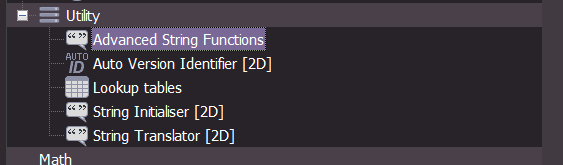

Right I've made something which may or may not be useful for this.
https://www.flowcode.co.uk/wiki/index.p ... _(Utility)
I've pushed it to the v9 and v10 component library update systems.
Let me know if you think of any other functions you would like added.

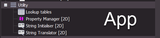

It' looks good. Just it's missing for the App Developer.
And the Auto Version Id would also be something for the app developer?

The component should be there for AD now. We are investigating adding the auto version component, it's a bit trickier but we have a plan on how to do it.

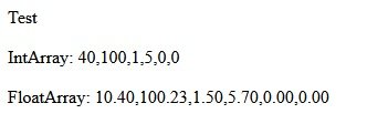

Hi Bob,
This should do what you're after. Make sure you do a full database library update to get the Advanced string component.
WebArrayIdea.fcfx
(17.24 KiB) Downloaded 586 times
