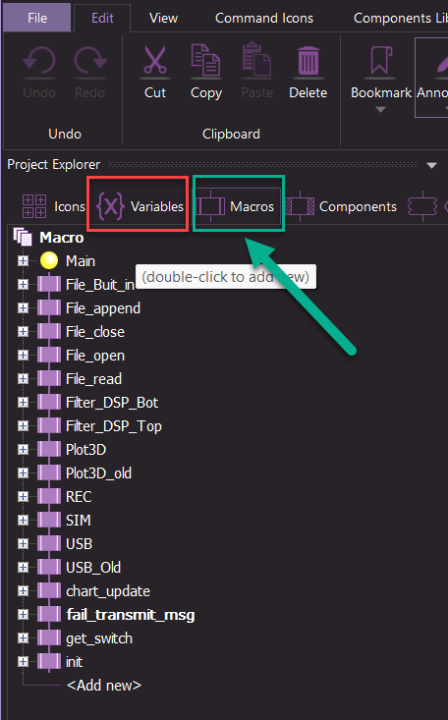

If I choose to see the macros, every thing is working fast. When i press to see the variable it's need 20 second to change to variable and from now FC10 is very slow to work.
Then I go back to see the macros again it's need no time and FC10 is very extrem fast.

In v10, if the Variables tab is open, it might try to update all the variables during simulation. This can be prevented if you have the simulation speed set to "Fast (no updates)".

Yes in FC10 V10.0.1.18. (and before )
The simulation works perfect and while the simulation is working to jump between variable and macros tab is fast..
But while "normal programming" it's slow to jump and working if the variable tab is selected.All another tab are fast and no problem.

This issue will affect any project with a lot of variables and a lot of macros and is caused by a check to see if the variable is being used in the project every time the list is redrawn.
The workaround for now is to avoid using the "Variables" tab unless it is necessary.
