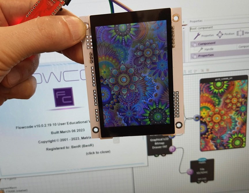

by BenR
Hi Jorgen,
Thanks for posting the attachments.
I've started having a look through your files but nothing is immediatley obvious so far. I'm assuming your up to date with your library updates.
- 20230306_140538.jpg (100.44 KiB) Viewed 5615 times
Looks like I maybe need to re-look at the gamma settings, the blue seems to be a bit out of balance.
