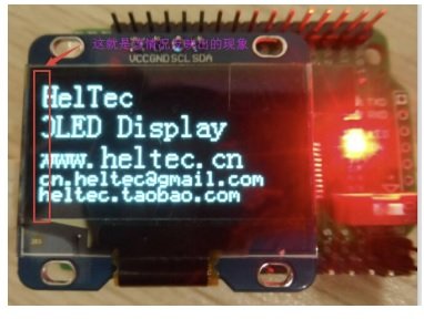

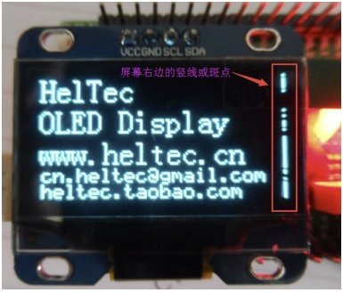

Reading the Heltec Oled datasheets revealed that there are some common problems.
According to the common problem sheet reveals issues with the first and last pixels of a line.
This is a production issue..
So fiddling with the Pixel Width or Offset X properties solves the problem.
In this case i had to shift two pixels to the right..
Learning curve...
