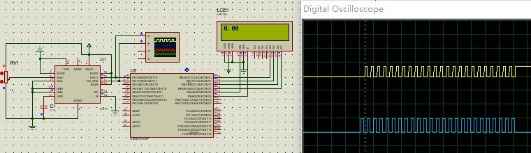

The example in V10 Help.The macro instruction"sample"does not exist.only"Rawsample".If replaced, the output data is also wrong。In V8, it's intact.Please help me。Thank you very much.

Many thanks for letting us know. I've updated the wiki example and also fixed a simulation bug that was present with the zero function.

After updating V10, I did a test, whether in practice or in proteus simulation, the output data was still wrong. This has always been true in V8.
