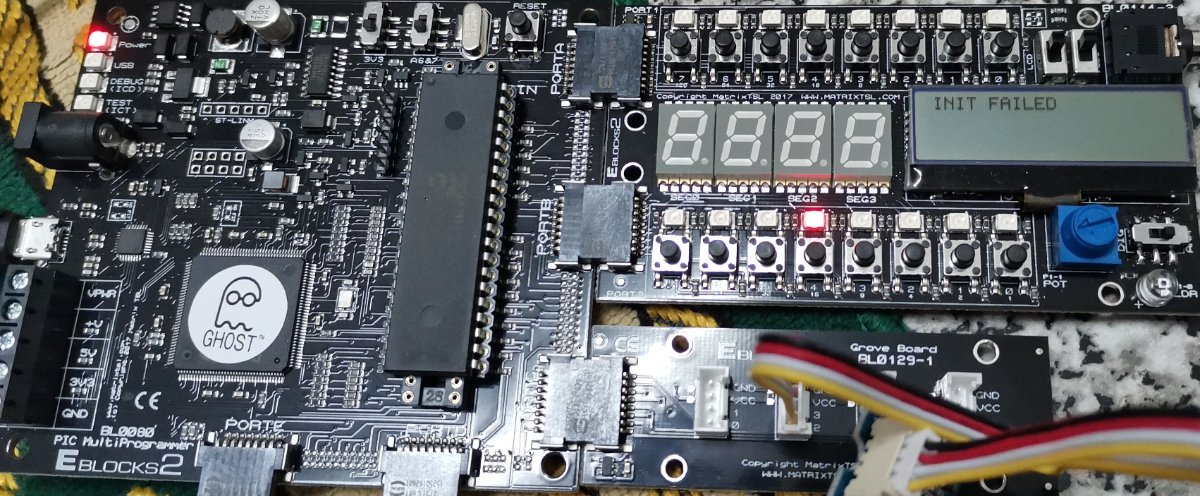

I can't able to read data from Accel Gyro 6_Axis LSM6DS3 (105020012) component. I'm using BL0080 - 8-Bit PIC Multi-Programmer. I connected the SDA and SCL to the right pins in flowcode. However, all my trial fail.
Kindly, find the attached files for more info.

Hello, I have developed a Project just for your situation.
Can you compile and run the attached project and let me know what the display shows, please?
Ignore any warning that This project was built with a newer version.
Re: Unable to read data from Accel Gyro 6_Axis LSM6DS3
Posted: Wed Mar 15, 2023 6:37 pm
by Emad2023
Thank you Mr. medelec for your cooperation. The address for the Accel Gyro 6_Axis LSM6DS3 board is the same as I configured.
I think there is another issue !!
