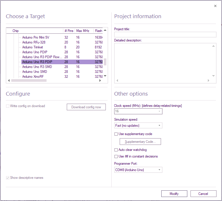

With only the Arduino Uno connected to the PC via USB
If you select
Build >
Project options, you should have something like this:
- Using Ardunio Shield..png (46.73 KiB) Viewed 14325 times

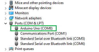

Yes, it's vital that when you plug in the Arduino, a VCP (Virtual Com Port) is automatically set up like this:
- Arduino VCP.png (11 KiB) Viewed 14309 times
For that to happen you must have the correct drivers installed.
Some Uno's will work straight away as windows will have the correct drivers by default e.g. Dip version
For other Uno's e.g the SMD version, you will have to manually add the drivers.
I believe it's the CH340 drivers.
I have attached the drivers for you to try.
