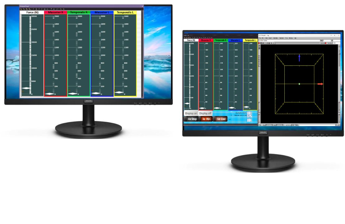

I'm working with 3 Monitor and it's very comfortable to programm with few 2panel and a 3D Panel.
But with the deployd App I work on one or two monitors.
So if some panel are not visible on the main monitor,
I have no way of moving the position of the panels back on the main monitor.
Can I do this with a built-in function? By programming and pressing a switch?
But I can't find a handle (name) for the panels.
Simbolic representation of the app on two monitors as they work in practice

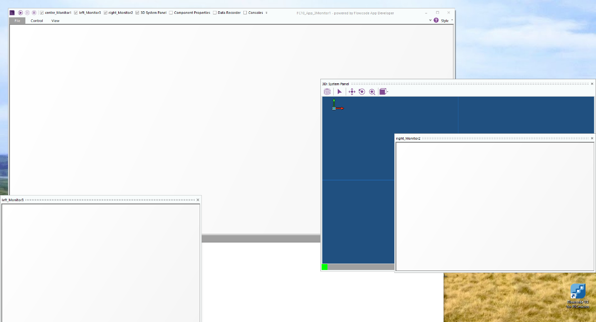

Hi Stefan,
Here's what that app looks like when I open it on my PC with 1 monitor. With 2 monitors, one panel is on the left and the others are on the right.
I will try to discover if Windows 11 is doing something different for me and if so, why.

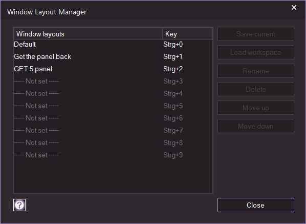

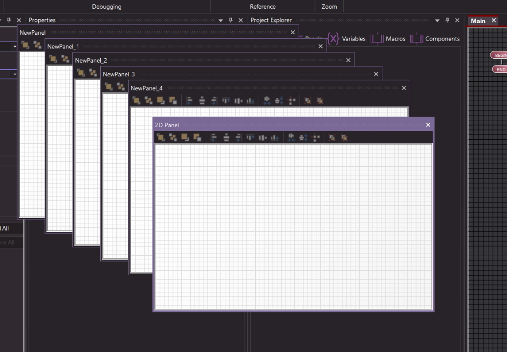

For the program mode I found a way to get the panel back and before I deploy a have the press this button ....
make a new App with some panel nicely arranged:

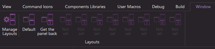

got to windows:
use Layout manager and save a preset:

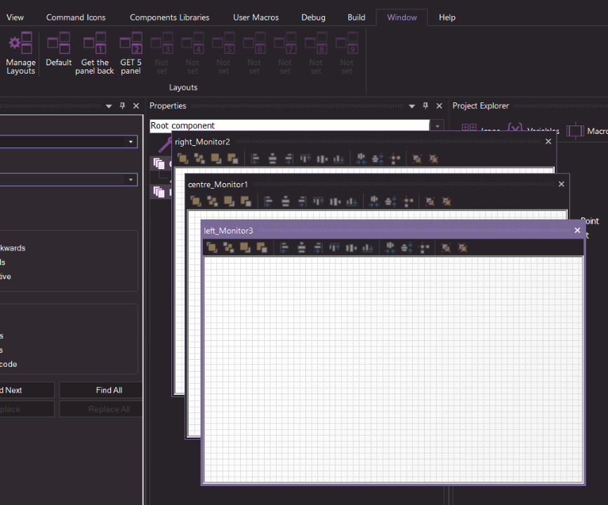

open the program with the missing panel and press get 5 panel and all panel are back:
a little strange, you can not yet touch the panel... but once again open/close the layout manager then you can use the panels nice again:
