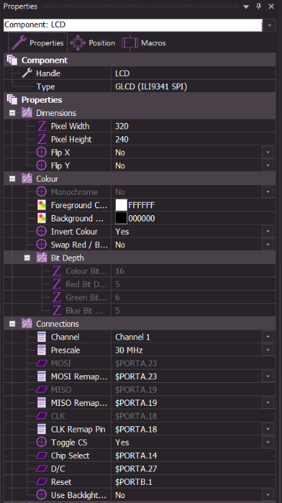

FC10
I made a test with the highspeed SPI config on the ILI9488 and the prescaler is max. 60 Mhz I suppose it´s because the size, but clearly noticeable.
But now the entire display/text is mirrored? It work in the other configuration.
Is it possible to fix this without it going beyond and effect my old projects where I use random legs, pls?
Br jorgen

Hi Jorgen,
If you use the FlipX or FlipY property then hopefully this will remove the text mirroring issue for you.

by jgu1
Of course Ben, thanks a lot.
