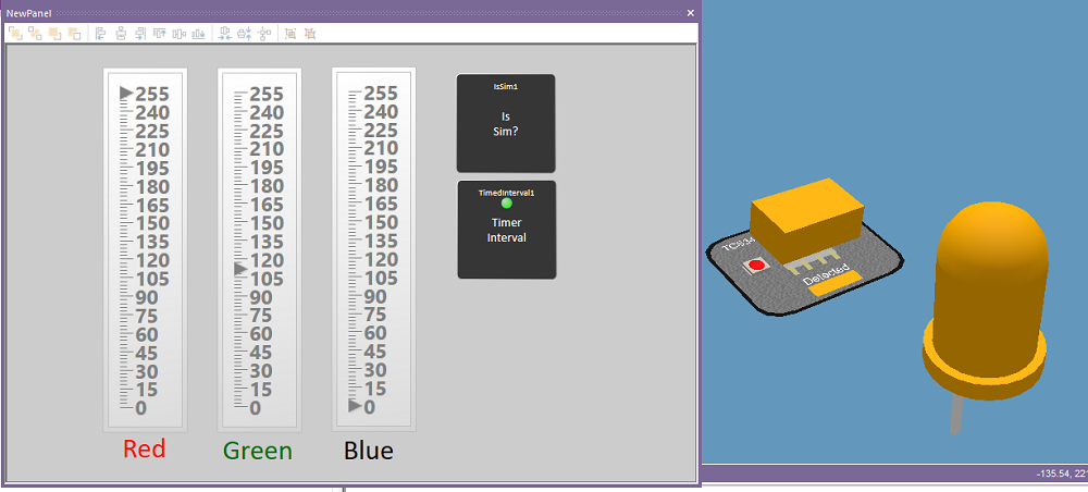

The attached project will only simulate if you use that attached updated component.
To do that before the updates are pushed.
Browse to this location using file explorer, it's hidden by default so just paste the link into your address bar.
C:\ProgramData\MatrixTSL\FlowcodeV10\Components
Replace the existing files with the attached Grove_I2C_Color_Sensor.fcpx file.
If you run any component updates, then the components you added will be overwritten.
The Original component won't stop the hardware from working.
The simulation works by adjusting the RGB controls on the 2D panel.
The Red, Green & Blue text will change colour depending on the settings.
TCS34725 Simulation.png (175.64 KiB) Viewed 4359 times
The data and clock pins are chosen to work with Eblocks2 Grove board BL0129 and the Grove I2C colour sensor PCB.
If you don't have them then you will need to change pins accordingly.
You will need to take in to account that the sensor can output a 16bit value, if bright enough.
The RGB led only takes an 8 bit value.
Therefore you may need to play around with the sensor gain to make it work better.
