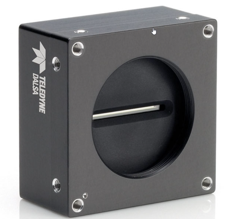

A professional linear camera over network (GIGE) with up to 80000 lines per second

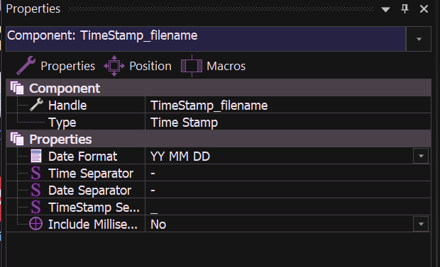

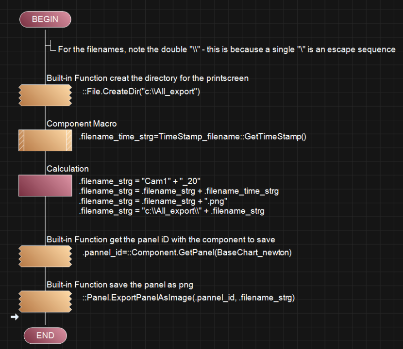

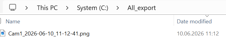

Now I just need to figure out how to save the photo in the folder with a date and time stamp after clicking “Take Photo.”
like this:
C:\All_export

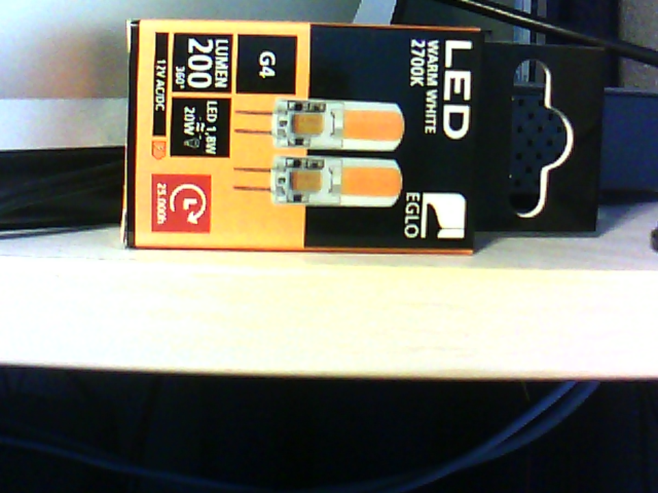

Here is a photo I just took as an example
download (7).png (1.05 MiB) Viewed 1002 times
