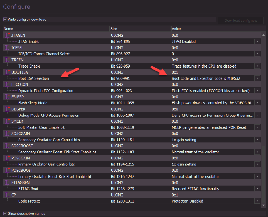

Hi SpeedPIC32
Can you check if your PIC32MZ is MIPS32 ?
Change to MIPS32

5. can you check if your PIC32MZ is a MIPS32?
yes the PIC32MZ is a MIPS32 and also programmed that way.
