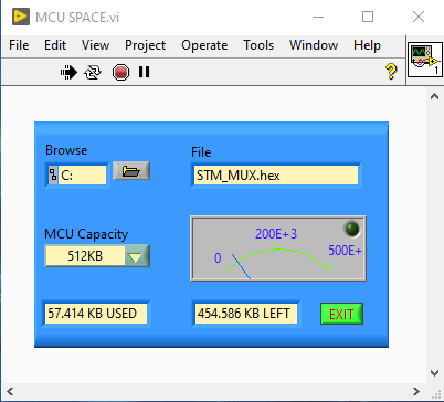

Hi Oscar, Thanks for your reply
I have searched a bit on the net and could not find a tool that does that so I thought
I build one myself and dedicated around 2 hours to this.
Using Labview I was able to build a tool that reads the hex file and calculates the space taken and what's left
here is a screen shoot

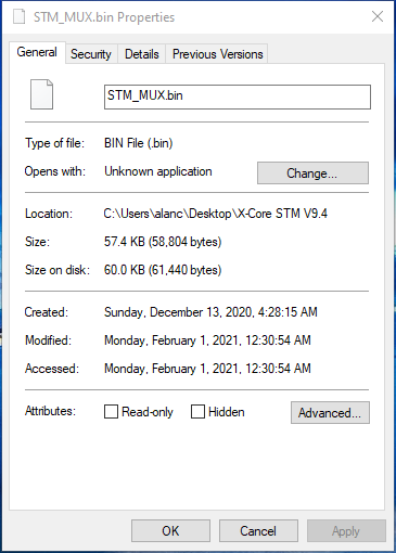

but then I found out that because the STM compiler also produces the bin file was much easier to just look
at the bin file size but ok at least I could verify that the tool works well as you can see from the properties
of the bin file below

I am Attaching the file maybe someone can find it useful ( MCU SPACE.zip) it can only be opened with Labview 2019.
