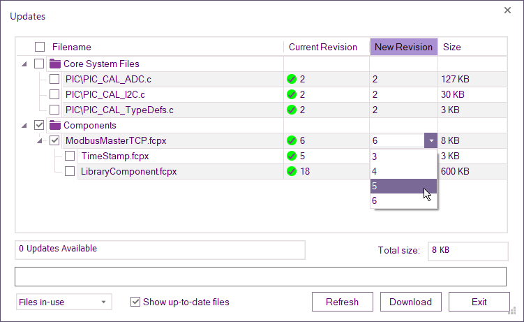

Is it possible to revert back to a component that worked fine for a while?
Re: Modbus / TCP Error
Posted: Mon Jul 17, 2023 3:31 pm
by Steve-Matrix
seokgi wrote:
Mon Jul 17, 2023 1:34 pm
Yes, this is always possible. In the Library Updates screen there are 2 columns shown, "current revision" and "new revision", and the latter allows you to choose which version to download and use within Flowcode.. If you select "show up-to-date files" when you have your project open, it will show all applicable files in your project. You can tick the file and select an earlier version in the "new revision" dropdown, then click "download".
We do recommend you always use the latest versions of the files, but reverting to an earlier version while we investigate the problem can help you continue developing your project until we provide a fix.

Can you tell me how to revert the modbus/tcp component to an older version?
Posted: Mon Jul 17, 2023 4:37 pm
by Steve-Matrix
The instructions were in my previous message. An image may perhaps explain this better:
Update to earlier component version.png (34.3 KiB) Viewed 6076 times
You will see that the ModbusMasterTCP component has two subcomponents and you may need to revert these to earlier versions as well (or instead).
