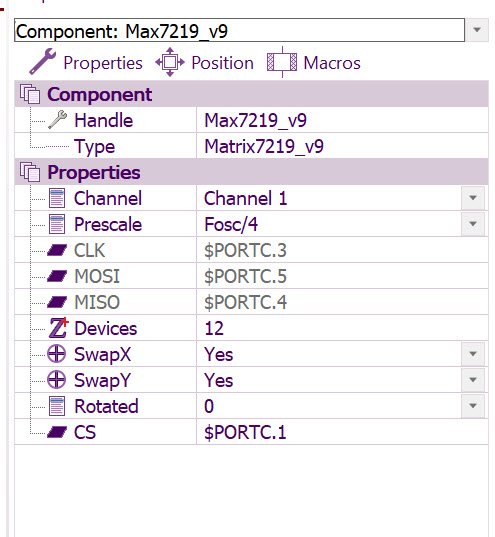

Are you setting the pins in properties (including CS)
This should run through some demo routines...
I used the 18f252 but should work with others if they sufficient RAM - it uses 8 bytes for each of 16 displays (max allowed as far as I remember)
Note also that it doesn't do anything in simulation.
