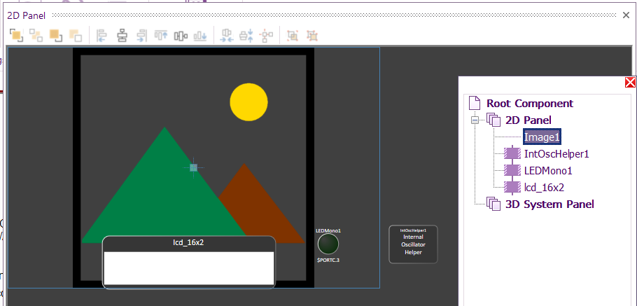

I've opened your project in v10 and it loads correctly for me, although I do not have the image file so it shows a placeholder instead. Here's what I see, with the list of components:
2D panel test.png (50.01 KiB) Viewed 4299 times
I suggest you ensure you are using the latest v10 version (v10.0.4.33) and are fully up-to-date with library file updates. Then close all instances of Flowcode down and reload a single instance and try opening your file.
Also, does the attached file open correctly for you? If so, and the files you create are still misbehaving, then maybe start a project with just a single component and see if that works ok.
And if you are still experiencing the issue, is there anything unusual about your Windows setup? I have never seen the behaviour you describe. And we have a lot of users of v10 and I would expect this to have been reported previously.
