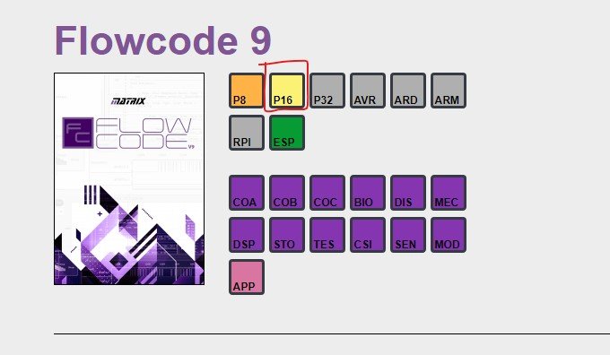

hi,
I have contacted Alfie Dobson and now I have the licence PIC16 toolchain
See web picture

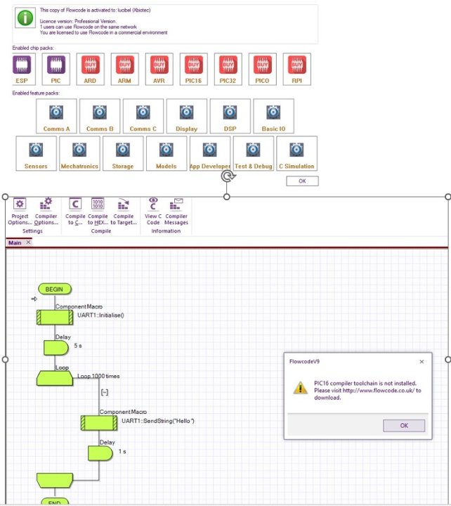

see picture from FC9

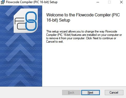

but when I'm installing it's always install it on FC8 !

so I have:
1- uninstalled the PIC16 toolchain
2- restarted the computer
3- start flowcode as you can see the PIC16 is disabled
try to compile to see the error message : PIC16 compiler toolchain is not installed

Install PIC16 toolchain
installation is showing FC8. may be not a problem because compiler seems to be same for FC9 and FC8.
Done. see below

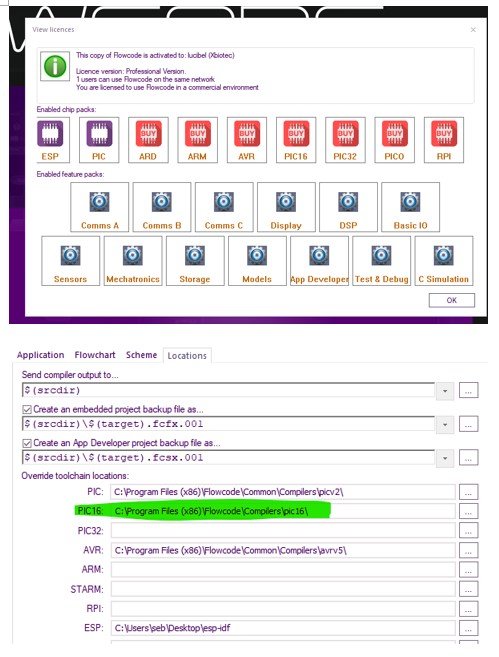

Try to compile. Error message is now : You don't have valid licence to perform this action
PIC16 toolchain installed.jpg (64.87 KiB) Viewed 12005 times

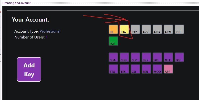

Re: PIC16 toolchain for FC9
Posted: Tue Sep 05, 2023 8:00 am
by medelec35
Hi Seb
Can you try reactivating your license?
When first loading Flowocde, it can be done via Licensing > Manage > My Flowocde Licence
Or if you already have a project open, it's via Help > Licensing > Manage > My Flowocde Licence.
You will need to reenter your username and password.
Finally, restart Flowcode.
Posted: Wed Sep 06, 2023 8:11 am
by Xbiotec
hi Medelec,
sorry for my late reply.
what you didmake it working now .
thx lot

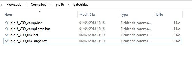

This might work for the new XC16 compiler:
  1. Install the new compiler in a separate location
  2. Copy the "batchfiles" folder from the old installation to the same place as the new one
    -- the "batchfiles" folder should be at the same 'level' as the "bin", "etc", "include", etc.
  3. Point Flowcode to the new installer location within Global Options...Locations
    -- this location will be the folder containing the copied "batchfiles" folder
  4. Restart Flowcode
Please let us know how you get on.
(edit: these instructions are not quite correct - please see later in this thread)
Posted: Wed Sep 06, 2023 10:28 am
by medelec35
thx lot
Hi.
I refreshed your licence.
