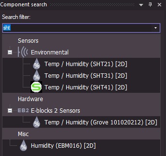

Thank you for the good tips and support. I changed the address.
It's working now with the SHT41.
I have noted my changes in the pdf and set the name of the component to Sensirion_SHT41

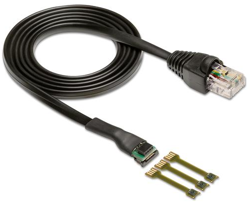

I will test more and later and I test also the STS41, a version Sensor from Sensirion only temperature.
Both sensor are avaible on a flexprint (FPCB) and really small...

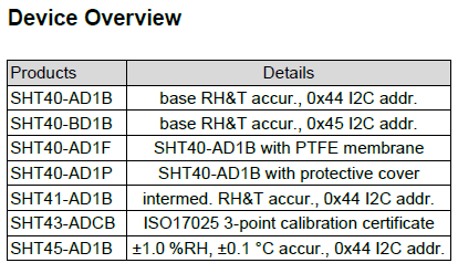

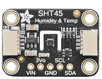

I am looking at the 4x series too. Mainly the 45, do you have a way of checking accurately the temperature ?
Data sheet here if anyone else interested:
https://sensirion.com/media/documents/3 ... HT4x_1.pdf
I might have to ask nicely see if we can get a module, and plot it against what the chamber says on a slow ramp.
