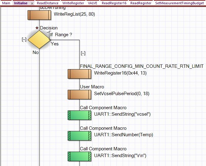

I was looking the code of the VL53L0X sensor.
Could you explain me why Macro "SetVcselPulsePeriod" is never used during initialize.
Range value is always 0
thx
Re: Component VL53L0X download problem
Posted: Mon Nov 20, 2023 9:56 am
by Steve-Matrix
As far as I can tell, this relates to a "long range / short range" option which is currently unimplemented in the component. If this is a feature you require then please let us know and we can look at implementing it.
