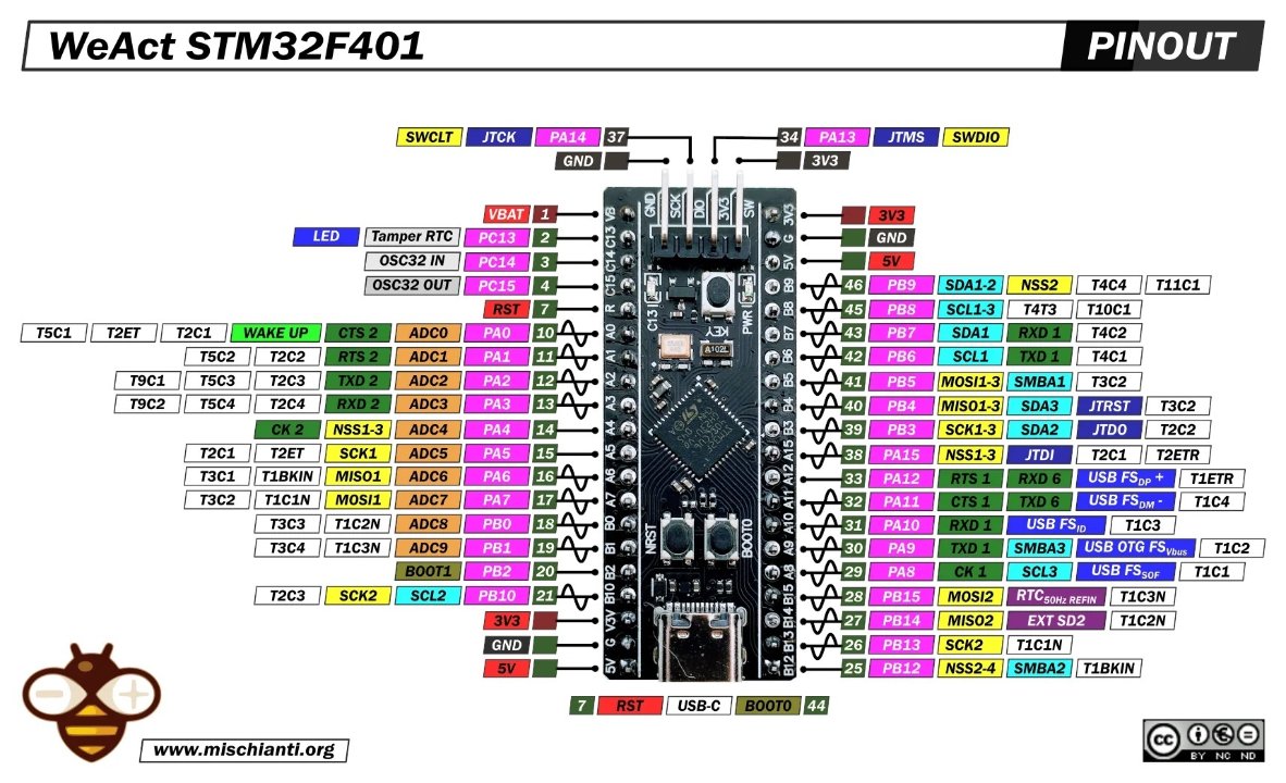

I am trying to use the below stm32f401rc Dev board for my Project so first thing
I try to make c13 blink, the chip will program ok but no blink , nothing is working
any idea what the problem can be ?
