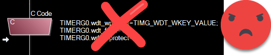

I found two problem.
The first:
I have to remove watchdog C code so then a test-program is compiling.

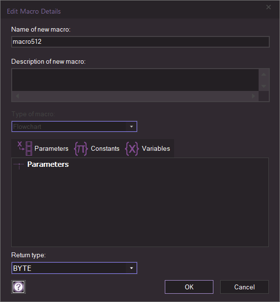

The second:
it's a little strange.
If I have a macro with a return type "Byte, Int, UInt...." it gives a fail
but if the return type is "string" then no fail...

Have you assigned a value to the return? I think the ESP compiler will error if there is a return that hasn't been assigned a value. For a string it's a pointer and so is probably less likely to moan about it not being populated as it's harder to know if it has been.
Yes I'm aware the watchdog timer fix code has stopped working, I need to look into this to find a new fix.

Yes, the ESP-IDF 5.12 need to assigned a value to the .return. (ESP-IDF 4 maybe not)
The testprogram 512_test_1.fcfx is working now.
